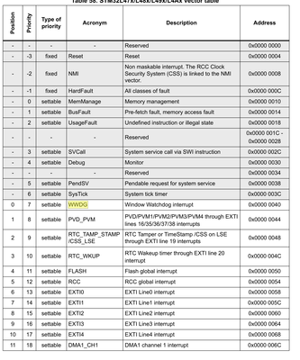

But when I was using NUCLEO-L476RG board, and created an Empty Project I was unable to trigger UserButton IRQ on PC13. After triggering the interrupt the code ended up not in my InterrupHandler routine but in DefaultHandler. Which prompted me to look at the autogenerated startup file and find that Interrupt Vector Table described there have nothing to do with Interrup Vector Table in the datasheet :grinning_face_with_sweat:.

And this is how beginning of the Interrupt Vector Table looks in datasheet:
I've checked in STM32CubeIDE and it's generating appropriate Interrupt Vector Table for this board, so it seems it's something isolated to the VSCode extension.

We confirm the bug. The issue can be re-produced!
FYI, we are generating the vector table in the startup-file on-the-fly by identifying the device name and pulling information from the "svd"-file. The new algorithm to do this generation does not yet have much mileage. We will look into how we can fix this.
In the meanwhile I attach a fixed version that you can drag-drop in manually...
  • I only did build test, did not have the device to run a debug session...
  • Checked it vs ref.man, I think it is OK, but manual copy-paste is also a source of error...
Hope it works out better for you. Thanks for bug the report!
