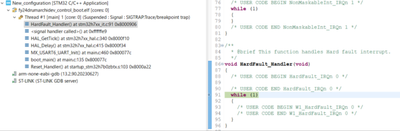

Here are my responses to your three questions:
How do you see the hard fault in the debugger?
Does your program break into debugger or hang?
Could you post a screenshot?
Please refer to the screenshot above.
The program enters a hang state because it remains in the while(1) loop.
What is the address and size of the affected live variable?
We have confirmed that this issue can occur regardless of the address or size of the variable.

Pavel A.
The whole call stack is in the internal flash (0x0800000...). No evidence of code running in the external memory.
Please use the hardfault analyzer of the CubeIDE to diagnose.
