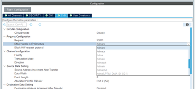

Hello @YoungKwan
Actually, you should modify the DMA Handle in IP Structure to hdmatx instead of hdmarx.

Hello @YoungKwan
