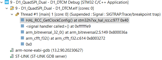

I succeed to run all demo programs of the H7 performance suite (STM32CubeExpansion_Performance_H7_V1.0.0) except the QSPI single mode demo (8 - D1_QuadSPI_Single - D1_DTCM) on STM32H753I_EVAL2. But I can run the dual mode demo (9 - D1_QuadSPI_Dual - D1_DTCM) successfully.
As far as I can see, both demos use the same source, the only difference is in the preprocessor settings, a symbol "QSPI_DUAL_FLASH" is present in the dual demo toolset settings. If this symbol is removed the same error as shown below appears too.
It seems that the call / execution of the FFT function crashes if run in the single QSPI mode. I can set a breakpoint on the function but as soon as I try to step over it
the debugger jumps to this line here in HAL_RCC_MCOConfig() function
which doesn't make much sense to me.
The debug window shows
According to the linker script, the fft functions are located in OSPI flash. The same code runs in dual mode but fails in single mode. This leads me to the assumption that there is something wrong in the QSPI interface configuration for single mode.
BTW: I can successfully run the memory mapped demo (as supplied by CubeMx for H743 evaluation board) in single and dual mode, also the XIP demo, which is also in single mode.
Any idea why the program above has stopped here? What can I do to gather more information?

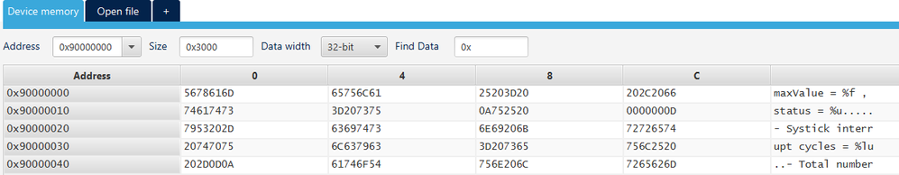

After running the demo in the CubeIDE, I can see in the CubeProgrammer that the code & data has been programmed into QSPI flash (I've erased the entire flash before):

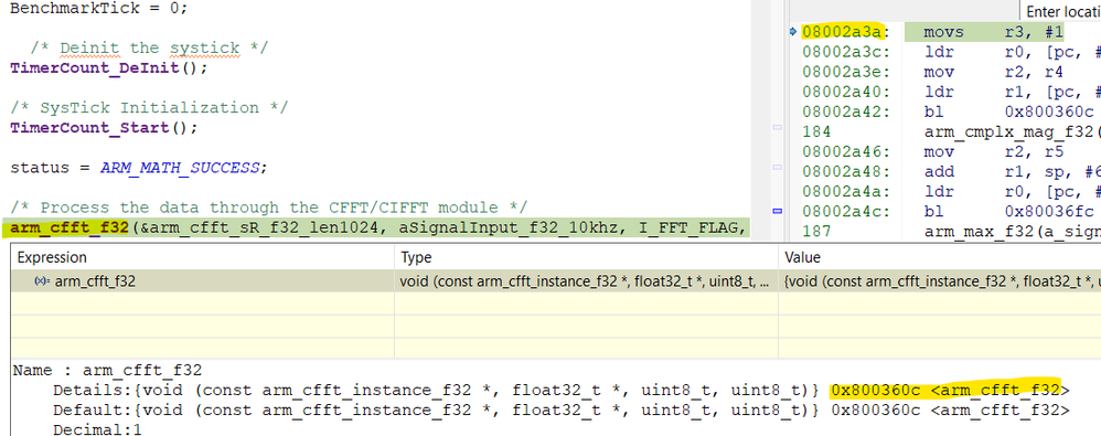

But according to the IDE debugger, the program code is executed from the internal flash:
I guess that the linker script here is not suitable to locate the FFT function code into the QSPI flash:

Regarding the constant data, these are placed into QSPI memory (Cube Programmer QSPI read):
Nevertheless, the .list file claims that the function code has been placed to internal flash:
0800360c <arm_cfft_f32>:
800360c: 2a01 cmp r2, #1
800360e: e92d 41f0 stmdb sp!, {r4, r5, r6, r7, r8, lr}
8003612: 4606 mov r6, r0
I guess that there is a problem with the linker script. Seems to me that only constants are placed to QSPI but code is placed to internal flash.

For me, the first section already commands the linker to put all text to internal flash, so there is no more text in the second section left to be placed into QSPI.

For a first test I simply put the QSPI section before the internal FLASH section:
.QSPISection : {
. = ALIGN(4);
*main.o (.text .text*)
*arm_bitreversal2.o (.text .text*)
*arm_cfft_f32.o (.text .text*)
*arm_cfft_radix8_f32.o (.text .text*)
*arm_cmplx_mag_f32.o (.text .text*)
*arm_max_f32.o (.text .text*)
*main.o (.rodata .rodata*)
*arm_common_tables.o (.rodata .rodata*)
*arm_const_structs.o (.rodata .rodata*)
. = ALIGN(4);
} >QSPI
/* The program code and other data goes into FLASH */
.text :
. = ALIGN(4);
*(.text) /* .text sections (code) */
*(.text*) /* .text* sections (code) */
*(.glue_7) /* glue arm to thumb code */
*(.glue_7t) /* glue thumb to arm code */
*(.eh_frame)
KEEP (*(.init))
KEEP (*(.fini))
. = ALIGN(4);
_etext = .; /* define a global symbols at end of code */
} >FLASH
Now the main and FFT functions are placed in QSPI flash. For me, this seems OK and now the execution performance dropped to 436us, factor 1.5 compared to internal flash, as mentioned in the FFT benchmark documentation. I'll check this in detail later.
