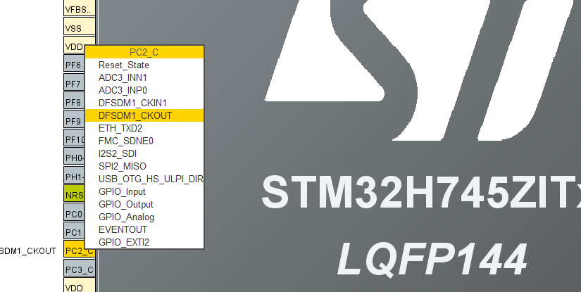

Is there any project to generate an Clock output of 20Mhz? I tried with TIM 16 but the best I can get is around 300 kHz

@ABlum.2​ That pin has the DFSDM1_CKOUT option.0693W00000BaXMaQAN.pngI never used this peripheral but its meant for driving external ADCs so the DFSDM1_CKOUT pin can generate a very fast pwm clock signal for you.
Did you tried this already?

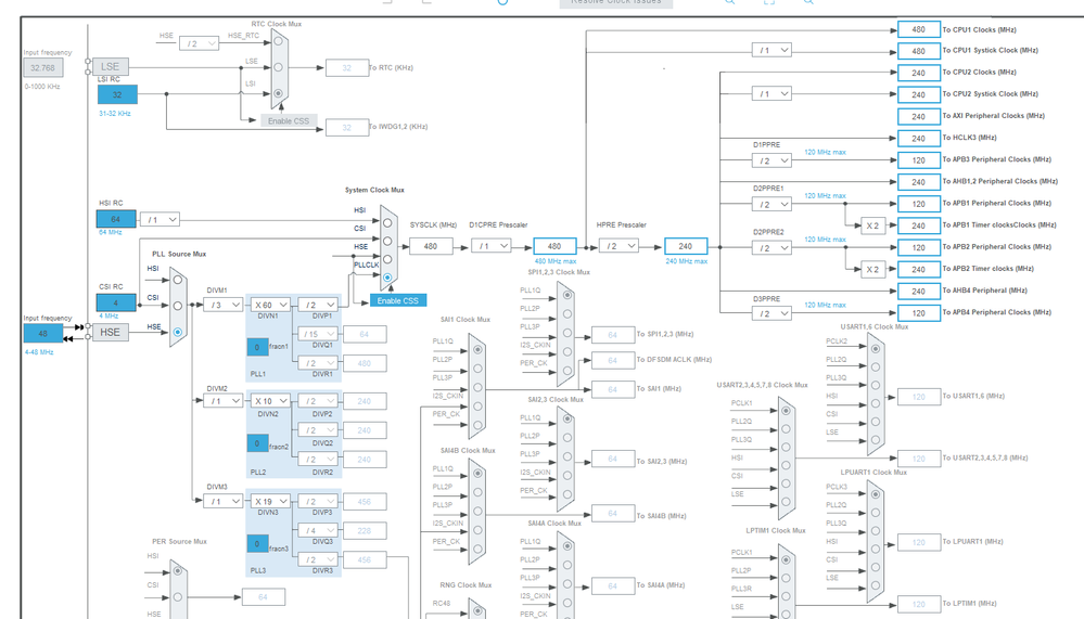

Are you using a XTAL as a HSEclock source?
How high is your system clock?
Maybe share a snap of your cubeMX page clock setup
Available for consulting/freelancing , hit me up in https://github.com/javiBajoCero
0693W00000BaVWsQAN.pngHi Javier,
Thanks for the answer here I send you a picture of the clock setup.

Sounds like you're trying to service an update interrupt rather than let the TIM control the pin directly. ​
Hi Tesla Delorean
Thanks for the answer. Yes the pin I need to control is not realted to any TIM (pin PC2_C) hence I need to toggled it to make the clock.
Regards
Alan

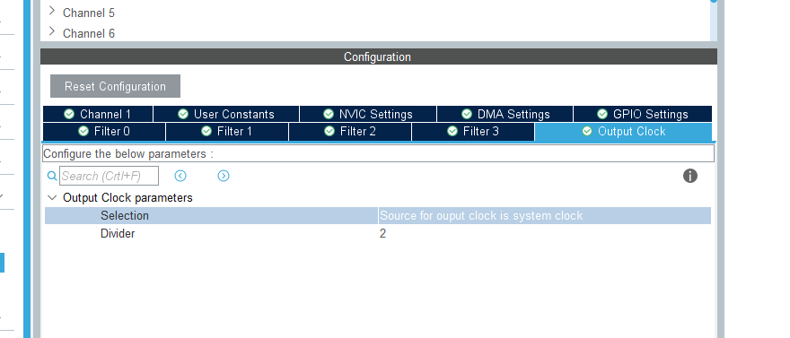

@Javier Muñoz​ thanks for the information, I will try this, where can I find this configuration from the image with the filters?
Regards
Alan Blumenstein
@ABlum.2​ Are you reffering to cubeMX?
The configuration appears under DFSDM peripheral config tab
