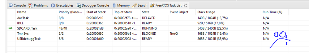

Currently, In my application two tasks running simultaneously.

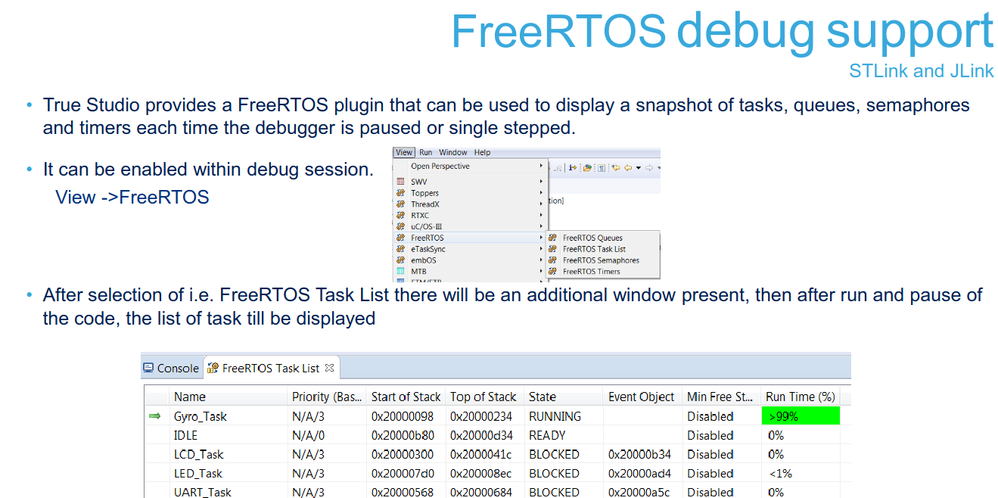

For specific task CPU usage I have followed the page No.251 steps in my STM32Cube IDE for finding the particular task CPU usage.
But, FreeRTOS Task List windows not updating the "Run Time" column value and it's showing the "N/A"
Could you tell me what is issue with IDE or if anything the FreeRTOS configuration side missing? or any version issue?
For more clarification, I have attached the screenshots from the document as well as from STM32Cube IDE.

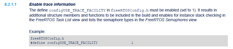

To be able to populate the FreeRTOS™-related views with detailed information about the RTOS status, some files in the FreeRTOS™ kernel must be configured.
Check the 6.2.1 paragraph from STM32CubeIDE user guide - User manual doc to find the description of what should be added.

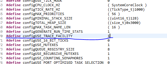

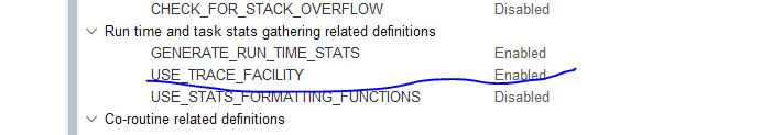

@Semer CHERNI​ thanks for your reply, as i read in the user guide:
  • First, USE_TRACE_FACILITY should be defined to 1.
0693W00000QNoGsQAL.pngI already configured this parameter in cubeMX0693W00000QNoHMQA1.pngI double checked and indeed is correctley defined in my file.
 So my issue wasnt that one

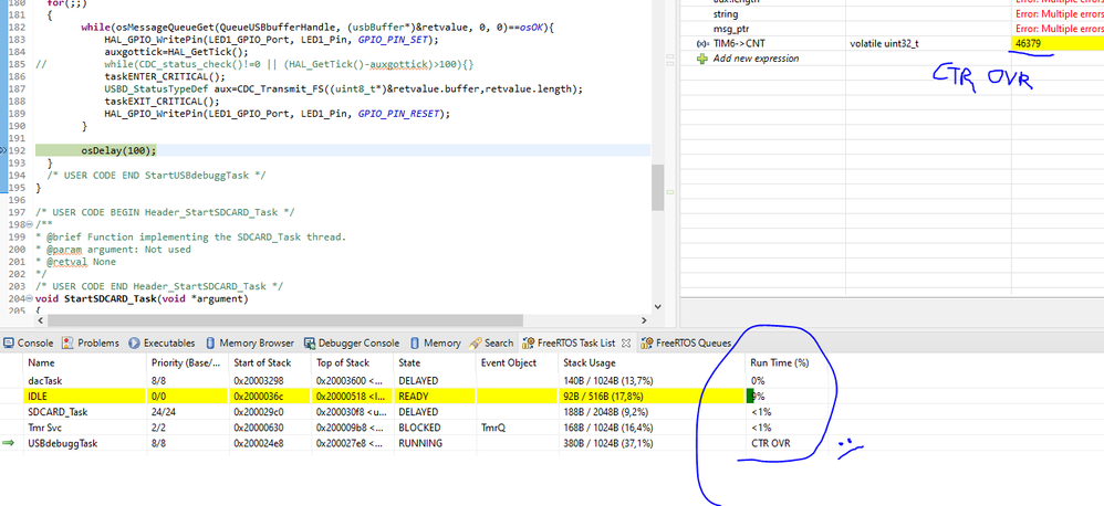

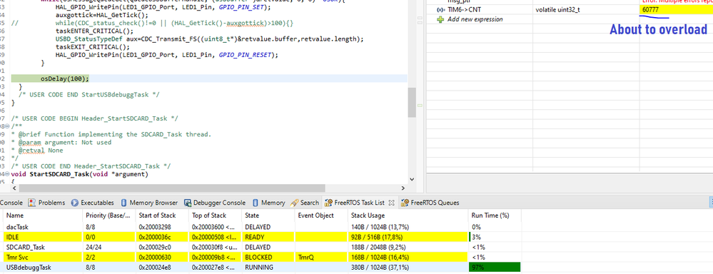

But still, I have one query as I attached the below image where you can see "CTR OVR" in the first row of the RUN TIME column.
So could you help me to figure out, what is the meaning of "CTR OVR"?
I am still trying to get RUN TIME(%), did you do something special?
i started looking into FreeRTOS's own user guide about Run Time Stats.
I cannot see where cubeMX generated the 10xfasterthansystick counter.... the functions seem to be empty, i believe we should use a dedicated timer for this and it wasnt obvious for me.

I finally got it, i set the TIM6 (no interruption) as 10x faster than freertos systick, then i use its CNT register as counter for getRunTimeCounterValue.
As the timer has a 16bit register i could only debug the first 6,5seconds.
After 6,5 seconds i get "CTR OVR" (@HPate.10​ counter overaload?) meaning i need a bigger storage for the run time counter variable
