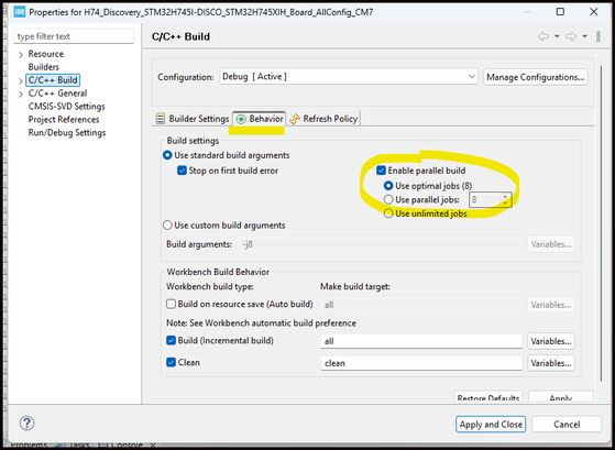

How to configure parallel compilation in cubeide, that is, "j-4" "j-8" and I encountered an error in the Windows 87 code, how to solve it, I changed the path and still couldn't do it

process_begin: CreateProcessW(E:\Esoft\CodeAPP\STM32\STM32CubeIDE_1.19.0\STM32CubeIDE\plugins\com.st.stm32cube.ide.mcu.externaltools.make.win32_2.2.0.202409170845\tools\bin\sh.exe, E:/Esoft/CodeAPP/STM32/STM32CubeIDE_1.19.0/STM32CubeIDE/plugins/com.st.stm32cube.ide.mcu.externaltools.make.win32_2.2.0.202409170845/tools/bin/sh.exe -c "arm-none-eabi-gcc \"../Middlewares/Third_Party/FreeRTOS/Source/list.c\" -mcpu=cortex-m3 -std=gnu11 -g3 -DDEBUG -DUSE_HAL_DRIVER -DSTM32F103xB -c -I\"D:/studystudystudy/Cube_32F1/fishboat_2/Middlewares/Third_Party/FreeRTOS/Source/portable/GCC/ARM_CM3\" -I\"D:/studystudystudy/Cube_32F1/fishboat_2/Middlewares/Third_Party/FreeRTOS/Source/CMSIS_RTOS_V2\" -I\"D:/studystudystudy/Cube_32F1/fishboat_2/Drivers/CMSIS/Include\" -I\"D:/studystudystudy/Cube_32F1/fishboat_2/Drivers/CMSIS/Device/ST/STM32F1xx/Include\" -I\"D:/studystudystudy/Cube_32F1/fishboat_2/Drivers/STM32F1xx_HAL_Driver/Inc\" -I\"D:/studystudystudy/Cube_32F1/fishboat_2/Drivers/STM32F1xx_HAL_Driver/Inc/Legacy\" -I\"D:/studystudystudy/Cube_32F1/fishboat_2/Middlewares/Third_Party/FreeRTOS/Source/include\" -I\"D:/studystudystudy/Cube_32F1/fishboat_2/Core/nmea_GPS/GPS_Src\" -I\"D:/studystudystudy/Cube_32F1/fishboat_2/Core/nmea_GPS/nmea\" -I\"D:/studystudystudy/Cube_32F1/fishboat_2/Core/BSP_Inc\" -I\"D:/studystudystudy/Cube_32F1/fishboat_2/Core/Inc\" -I../Core/Inc -I../Drivers/STM32F1xx_HAL_Driver/Inc/Legacy -I../Drivers/STM32F1xx_HAL_Driver/Inc -I../Drivers/CMSIS/Device/ST/STM32F1xx/Include -I../Drivers/CMSIS/Include -I../Middlewares/Third_Party/FreeRTOS/Source/include -I../Middlewares/Third_Party/FreeRTOS/Source/CMSIS_RTOS_V2 -I../Middlewares/Third_Party/FreeRTOS/Source/portable/GCC/ARM_CM3 -Os -ffunction-sections -fdata-sections -Wall -fstack-usage -fcyclomatic-complexity -MMD -MP -MF\"Middlewares/Third_Party/FreeRTOS/Source/list.d\" -MT\"Middlewares/Third_Party/FreeRTOS/Source/list.o\" --specs=nano.specs -mfloat-abi=soft -mthumb -o \"Middlewares/Third_Party/FreeRTOS/Source/list.o\"", ...) failed.
make (e=87): ��������
make: *** [Middlewares/Third_Party/FreeRTOS/Source/subdir.mk:37: Middlewares/Third_Party/FreeRTOS/Source/list.o] Error 87

Here:
Make error 87 often means exceeded length of the command line of compiler or other tool. This should not occur on modern supported Windows versions. Check that you've enabled the Windows option that removes the legacy path length limit.
Also, try the internal builder.
