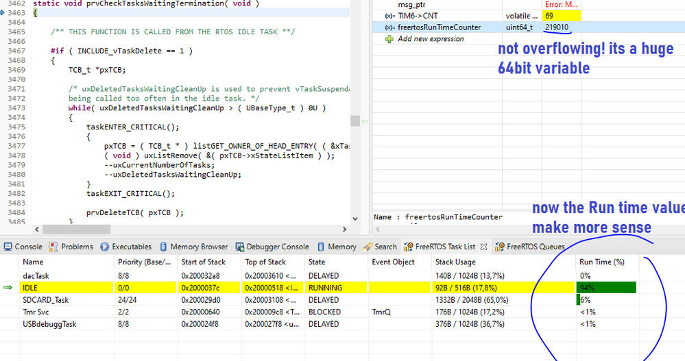

Currently, In my application two tasks running simultaneously.
For specific task CPU usage I have followed the page No.251 steps in my STM32Cube IDE for finding the particular task CPU usage.
But, FreeRTOS Task List windows not updating the "Run Time" column value and it's showing the "N/A"
Could you tell me what is issue with IDE or if anything the FreeRTOS configuration side missing? or any version issue?
For more clarification, I have attached the screenshots from the document as well as from STM32Cube IDE.

2022-08-17 1:58 AM
In order to solve the CTR OVR issue i configured TIM6 as interrupt triggered priority 0, it triggers every 0,1ms, incrementing a uint64_t variable.
/* USER CODE BEGIN 1 */
extern uint64_t freertosRunTimeCounter;
extern TIM_HandleTypeDef htim6;
/* Functions needed when configGENERATE_RUN_TIME_STATS is on */
__weak void configureTimerForRunTimeStats(void)
freertosRunTimeCounter=0;
HAL_TIM_Base_Start_IT(&htim6);
__weak unsigned long getRunTimeCounterValue(void)
return freertosRunTimeCounter;
/* USER CODE END 1 */

2022-08-19 2:06 AM
Hello
The user guide instructions contains PSEUDO Code. The reason to use the Pseudo code is that there are many use case depending on the used libraries , hardware configuration, available system resources, etc...
Here are an example implementation based on the HAL library.
FreeRTOS debugging on STM32 – CPU usage – MolesBlog (the78mole.de)
