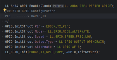

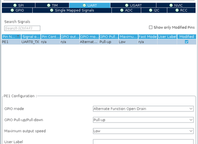

[BUG][STM32CubeMX 6.16.1] No pull up on UART8 single-wire.
Nicolas_B
Pull field is not set on UART8 GPIO when configured as single-wire.
STM32H743 / STM32H753.
Hello @Nicolas_B
Let me thank you for bringing this issue to our attention.
An internal ticket was submitted to the dedicated team (Ticket Number: 225731).
I will let you know when the issue is solved.
As Workaround, I suggest that you add GPIO_InitStruct.Pull = LL_GPIO_PULL_UP under
static void MX_UART8_Init(void):
Thanks.
Mahmoud
