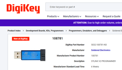

If it is an ST-LINK/V2, please include photos of the front and back so that it can be ruled out that it is one of the clones being referred to here.

Hopefully our ST-Links are legit.  We bought them from Digi-key.
What changed: It appears that the interface board that we use to go from the 20 pin 0.1" spacing cable to the 0.05" 10 pin cable has worn out.  So that's the source of my problems.
Even DigiKey do sell clones:
Hence the request to see photos of what you're actually using.
