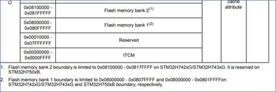

I program STM32H743ZGT6 with STM32CUBE IDE Version: 1.12.1.
The FLASH1 is full and i want to use FLASH2 => during the compilation i have an error (of course).
How can i use FLASH2 ?
At the start i grown up the FLASH1 as below but i think its' not adising :
/* Specify the memory areas */
MEMORY
FLASH (rx) : ORIGIN = 0x08020000, LENGTH = 768K
FLASH2 (rx) : ORIGIN = 0x081C0000, LENGTH = 128K
DTCMRAM (xrw) : ORIGIN = 0x20000000, LENGTH = 128K
RAM_D1 (xrw) : ORIGIN = 0x24000000, LENGTH = 512K
RAM_D2 (xrw) : ORIGIN = 0x30000000, LENGTH = 288K
RAM_D3 (xrw) : ORIGIN = 0x38000000, LENGTH = 64K
ITCMRAM (xrw) : ORIGIN = 0x00000000, LENGTH = 64K
Looking forward to your reply
Best Regards
Malo

Why you set the flash start not at the real start address ? (You loose first 128KB.)
> FLASH (rx) : ORIGIN = 0x08020000, LENGTH = 384K
+ set your bootloader to bank2 ?
or:
If need bootloader at bank1,
set your program to bank2 :
FLASH (rx) : ORIGIN = 0x08100000, LENGTH = 512K
btw
If this product is just for yourself, not for production in quantities, you could try the "2MB" setting :
This uses the 2x1MB flash, which is on chip, but you have a version with only 2x512K tested and guaranteed to work. But if your lucky, all 2 MB flash work fine - just try it.
You can separate data (used as eeprom) in FLASH2 and code in FLASH1.
But your situation still not clear.
You have a device of 2 x 512k of flash and in your linker file, you defined the first flash region that starts at 0x08020000 with size of 768K which is incoherent with your device usage. Even physically on the die there is the full 2M of flash but we cannot guarantee the second 1M as it was not tested.
Yes, its was a mistake
The FLASH is defined as below in my project
FLASH2 (rx) : ORIGIN = 0x08100000, LENGTH = 512K
The lenght of the FLASH is set to 384K and start to 0x08020000 because 128K is reserved to the BOOTLOADER (in my application)
What is the metode to separate data (used as eeprom) in FLASH2 and code in FLASH1 ? Or do you have an example ?

Hello, you can maybe add this section to the .ld file
.usr_part :
   KEEP(*(.usr_part))
  } > FLASH2
and then this attribute:
__attribute__ ((section (".usr_part")))
in the function decloration.

Hello NTaha.1,
Thank you for your response. your solution seems to work. I have tested with some function declared in FLASH2and now i have this result :
The size used by FLASH2 grow up and the size free for FLASH1 grow up.
Thank you again :)
