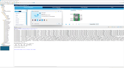

I've got a project that has the following files in the tree view:
All is well if I clean and build, but if I open the .ioc and "Generate Code", the tree changes to:
and the project then fails to build due to a duplicate system_stm32g0xx.c file.
Why is this getting added and how do I stop it?
I am using STM32CubeIDE V1.18.1.

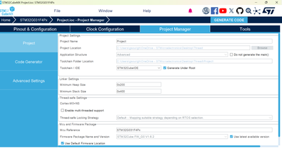

Try to use STM32CubeMX 6.14.1 standalone : this is the LINK to download it .
Open your IOC using STM32CubeMX 6.14.1 standalone then generate the code using STM32CubeIDE as shown
I will be waiting for your feedback.
THX
Ghofrane
CTapp.1
CTapp.1Author
Senior III
April 23, 2025
Hi @Ghofrane GSOURI
The code is generated as expected when using the standalone MX 6.14.1 - the second system_stm32g0xx.c is not generated in the templates folder, and the code builds successfully.
Does this mean there is an issue with the integrated MX in IDE V1.18.1?
