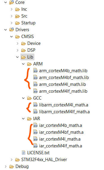

I've followed this tutorial to install the DSP libraries on STM32F407 discovery.
Should I keep all the files in the folders in the attached picture? Or only one per folder? (i.e. according to the uController I choose which one to keep)
I think I have to delete the IAR and GCC folders, leaving only ARM, am I wrong? And inside this ARM folder should I delete something? What's the difference between b, bf, l and lf?

Hello @luke514 ,

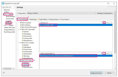

STM32CubeIDE use GCC compiler, so you need to keep the GCC folder.
Note that it is necessary, when you use the DSP Lib with STM32CubeIDE, to add the "arm_cortexM4lf_math" library and the path location file which is in a GCC folder (note 6 and 7 in the figure).
So, you don't need to delete any folder.

Hello @luke514 ,
