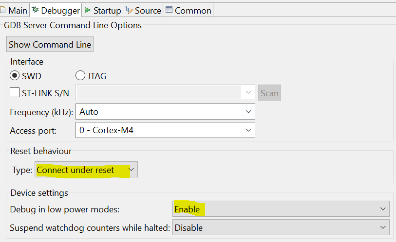

Hello @YO,
At first let me thank you for posting your issue.
The project that you are working on is not too much clear, it will be helpful if you could share it.
unless, you are working on a low power application I wonder you to enable low power debug mode and connect under reset as shown in the screenshot below:
Also, you have to mass erase the flash memory using the following link that may help you to do that:
How to solve debugger connection issues (st.com)
Regards,
Rim
‎2023-01-30 6:28 AM
Sorry for the delay in replying.
I am trying to run a program that worked on a Nucleo-L476RG on a L452RE microcontroller
I tried what you told me to do, but alas, I failed.
