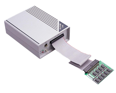

I remember the days when it was the only option without spending many thousands of $$$ on a large and unwieldy ICE!
But it is limited compared to SWD (or JTAG) - so not sure why @Domy_ST would want to go back to the Bad Old Days?
PS:
A real ICE:
