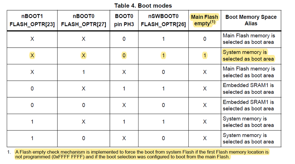

This is a system memory address, not a flash address. Your MCU does not boot from flash but from internel boot loader. Check boot pin / boot mode (user byte) settings.

it is a bit clearer. However, the BOOT0 pin is physically connected to GND by a 10k resistor. Looking at boot modes table, it seems I am in the below condition.
0693W00000QLjC3QAL.pngIs it possible that debugger erase memory but, at first time, not finding code in flash memory, starts from system memory?
Clicking at stop and run button, the program is downloaded correctly.
