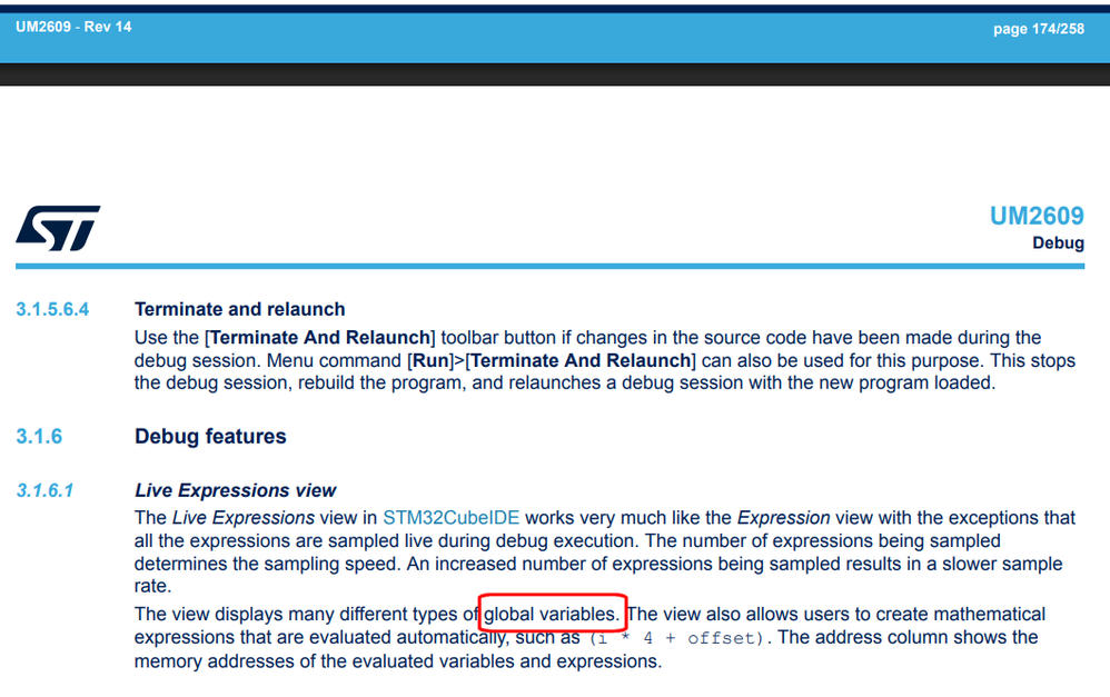

I run the Debugger and execute the statements until I get to the "if" statement above then when pressing F6 another time the execution stops waiting to read the value of pin 13 (the blue button on the board). But while I have also added "cnt" onto the "live expressions" its value doesn't go beyond 0 even though I press the button couple of times.
My purpose is to see the value of "cnt" after pressing the button no matter how much it is.

TechyAry
Apparently the problem is with `cnt` being a local variable. When I make it global, i.e., declared before `void run() { }` it works properly and Live Expressions shows a big number for it after pressing the button even only once.
That's another issue with using "Live Expressions" - the things you're watching need to be permanently visible.
Making it static (but still local) might work;
Making it static at file scope should work ...

@STTwo-32 perhaps this is something which needs to be made clearer in the UM?
