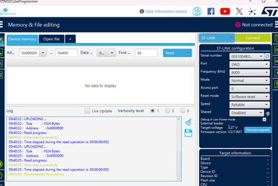

Show a screenshot after trying to connect with STM32CubeProgrammer.
Thaks for your responce.
I share a screenshot after trying to connect with STM32CubeProgrammer.
But sitll getting same error. Please provide me best solution to resolve the progrsmming issue.
Please find the updated required screenshot below.
Thanks and Regard
Manish Ruhela
Voltage is there. ST-Link programmer is there.
If it can't connect, a few things could be the issue:
  • SWDIO/SWCLK/GND wiring is invalid.
  • Chip is in low-power state or other state where SWD is inactive.
  • Chip is locked out (RDP level 2 - like state)
If it has never worked, might also want to check orientation of chip and workmanship of solder joints.
