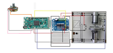

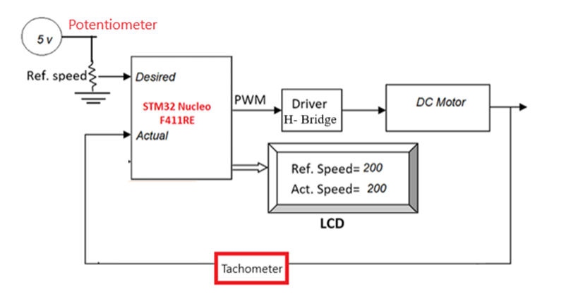

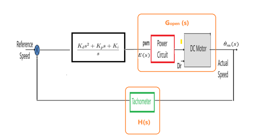

I have a project that requires Implementing a PID into controlling an DC motor (H-bridge), but im currently stuck on the code and other implementing stuff that i need help of. The desired Speed can be adjusted using the potentiometer, and the tachometer data sheet reads each volt equals 1000rpm. So im stuck here on whether to count the Tachometer as a timer or as ADC ? and im trying to figure out a good code, which i have written some of it that helps me achieve this, and exactly where to put the code of the PID ? If any of you can help i would be so pleased.

I dont have the data sheet but its a DC motor that looks exactly like the picture, and the tachometer is shown also, i need the code that runs this program or a little help in running it.
From the photo it seems the motor has a toothed gear on the shaft ,in that case there is a sensor on the board that translate(and greate ) pulses as the tooth gear passes the sensor (TTL signal) there are two ways which I know off
(1) is count the pulses per REV and from that derive the RPM
(2) meausre the frequence of the pulse train and  convert to time and from time you can derive the RPM
in my opin looking at the photo there is no adc involved however the phot does not clearly show all the components on it
Good luck
