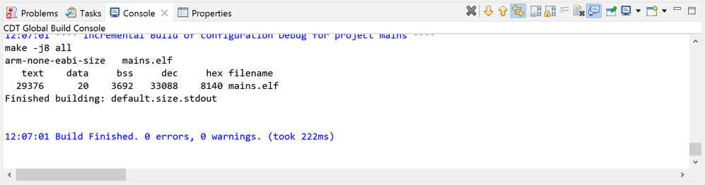

When I do a build in STM32CubeIDE 1.9.0 the console window looks like this:

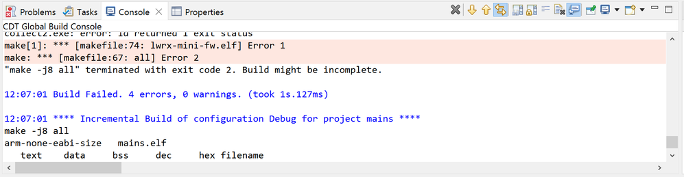

But if you scroll up a bit...
0693W00000NsMk6QAF.pngYou can see that the build actually failed. Those errors are real.
I could make the window a bit taller I suppose, but shouldn't it stop building when there is an error, and at least show the error and warning count on the very last line?

You are building multiple projects. That "Build finished" line is only for that project. The build probably does stop building the project with the error, but (obviously) continues with the other projects. Yeah it would be nice if there weer a "grand summary" status at the bottom of the console window. But, if you click on the "Problems" tab you should see any errors listed there from all the projects.

Just to add to the great information already provided, Ctrl + B is the binding for "Build All". This means that you would either need to right click your project and select "Close Unrelated Projects" to only have one open project or if you prefer to have multiple projects open but still use Ctrl + B then you can change the binding in "Window -> Preferences -> General -> Keys" to fit your purpose.
