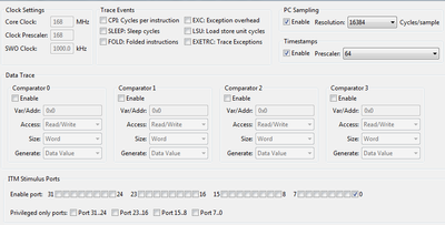

I have overall found this feature to be very unreliable, for reasons unknown. The data comes out OK from PB3 and goes all the way to the STLINK V3, at the expected speed, 1MHz, but Cube IDE displays nothing. I have this across a number of development units. Sometimes it works and then stops...
Anyway, digging into this, it looks like the entire trace macrocell is configured via the debugger when (or before) reset is released from the target. That is why none of the STM example code sets up any of this stuff. I also managed, years ago, to get SWV working not with Cube IDE but with the STM32 STLINK Utility, which presumably does the same via-debugger config tricks.
Also just because you see 1MHz stuff on the scope doesn't mean that it is in the right format for Cube IDE to decode it.
So I went looking for how to get this stuff configured in software in the target. Obviously any such config will override the Cube/debugger config so you will have to make sure Cube IDE's config matches exactly if you still want that to work. And after a lot of work I found the following, and wonder whether it is complete:

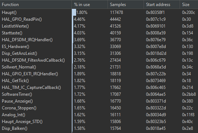

Basically the problem seems to be that frequent reading of the CYCCNT counter breaks the profiling.
Not at all sure how this is possible.

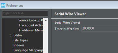

But I can work around that one. The bigger problem is that Cube IDE stops logging at approx 4095 packets. One needs way more... I've tried upping the buffer up to 200MB but it makes no difference. Is there a config for this value somewhere? It does look like there is a 4096 limit.

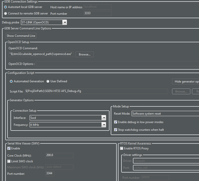

EDIT: seeing you using OpenOCD, I tried that, and it seems to work for both profiling and SWO debug. What a waste of time this has been. And I am still using STLINK V3.

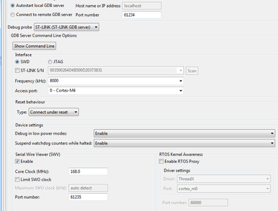

A final update on this dead horse flogging project:
OpenOCD did indeed make both profiling and SWV ITM debug working, with PC Sampling (obviously) enabled, concurrently.
But it then stopped and I could never get it back.
It looks like the debugger needs a power cycle, or maybe the PC needs a reboot, after any debug related config change. 100% definitely Cube IDE needs a restart after any change in the Project Properties / Debugger menu.
So I went back to STLINK GDB Server mode, just to get SWV ITM debug working.
One funny thing I noticed during when the profiling worked: some 30% of the time was spent in a function whose name was not recognised by Cube, whose base address was 0x1. This is nonsense; the code starts at 0x8000000 or some such. I would expect that much time to be spent in the RTOS Idle thread, as was found previously.

Again - are you using the ST own branch of OpenOCD? If you do, you could request support from ST. Of course a small, reproducible project for a well known board and clear description will be helpful.
PHolt.1
PHolt.1Author
Senior
Oct 3, 2025 8:15 PM UTC
"Again - are you using the ST own branch of OpenOCD? "
Yes.
It works a lot better than the GDB Server mode, although the latter has worked fine for normal program upload and breakpoint debugging.
