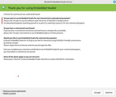

And of course all of the non-specific ones' like Keil uVision, IAR-WB, ADS, or others do. Including Segger's own Embedded Studio, which is free for non-commercial use.
I'm using the latter (Segger ES) for my private projects, and IAR-WB for commercial projects in my dayjob.
"Embedded Studio is available under SEGGER's Commercial Use License (CUL) (single user). This license is portable, meaning it is not limited to a single PC, and it can be stored on a J-Link, acting like a USB dongle. This allows full use of Embedded Studio on any computer. "
Just great (not) ;)
