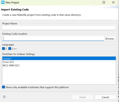

I used STM32CubeIDE a long time ago but then switched to another IDE. Now for some reasons I try to use again STM32CubeIDE.
I want to keep my build system (command line based on makefile and arm-none-gcc) and use the IDE only for debug.
Environment is windows + STM32CubeIDE v1.10 (I know it's old but I am not admin of my machine).
I created a "STM32 project" and linked it to my source directory tree then I went to Debug Configurations > STM32 C/C++ Applications > New configuration.
The first problem I had is that it doesn"t find the project, so I had to browse directly for the .elf
Then I disabled autobuild
And I've got the message "unsupported build configurations, MCU ARM GCC required for debug".
ARM-GCC was not included in this version of STM32CubeIDE ?
Am I doing it wrong ?

Please try  to import your makefile  project  :File > Import > Existing Code as Makefile Project
In this way STM32CubeIDE will treat your project as an STM32 ARM GCC project, even though you are building externally with your own Makefile. You can then set up a debug configuration pointing to your .elf file, and the IDE should allow you to debug without the previous error.
Please give this a try, and let me know the results. I’ll be here to assist further if you encounter any issues.

If I select "MCU ARM GCC" when creating the project and then set the STM32 device manually I am able to debug
Thank you
Hello @Gpeti
I’m glad to hear that the issue has been resolved.
The screenshot I shared displayed the default settings and of course you will need to select "MCU ARM GCC" to proceed.
