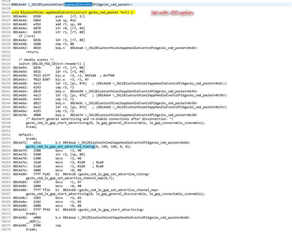

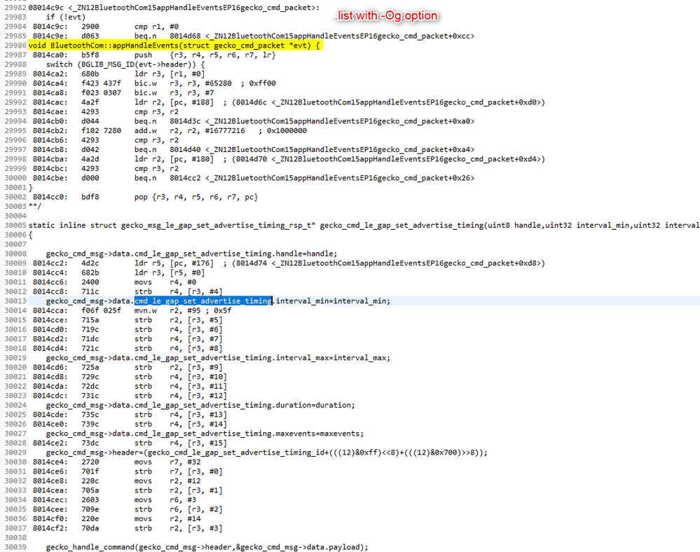

2020-06-01 1:24 PM
Thanks for your answers.
@Pavel A. i use source code (.c/.h) not a linked library.
@Community member , i suppose you talk about .list file generated by stm32cubeIDE ?
Under the result of this file for the method
void BluetoothCom::appHandleEvents(struct gecko_cmd_packet *evt)With option -O0
With option -Og
In debug mode (disassembly )
code working with -O0
With -Og

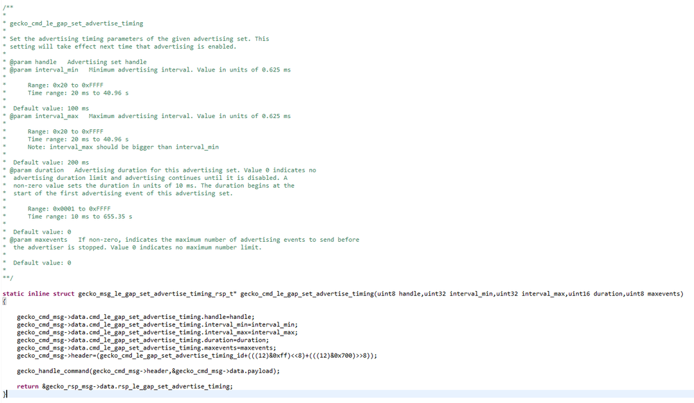

All the siliconLabs function is declared as static inline

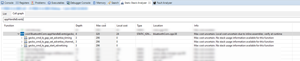

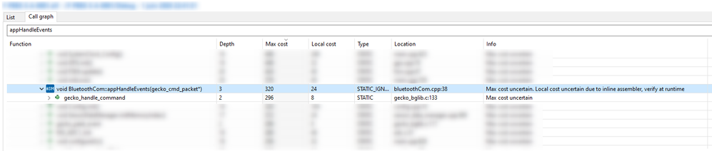

2020-06-01 1:47 PM
If it can help, the callGraph with -O0 option
We can see the SiliconLabs functions
with -Og option ?!

2020-06-01 2:48 PM
It has flipped the logic such that the case's body code are after the return()
The mvn.w r2,#95 is a byte load of 160, it is filling the structures directly.
The use of static functions allows the compiler much freer reign to fold the functions within the single object (source).

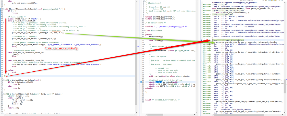

2020-06-02 1:59 AM
@Community member , yes i verify that in step mode after a breakpoint, the code in the switch is not executed
@Pavel A. the -Og option reduce the code size but it let you to have a good debug experience. If i use the O1/2 ... option the result his the same it seems the code is removed !
2020-06-02 2:08 AM
I did not ask if the code *was* executed, I asked, whether there *was a reason* for it to be executed:
>> Did you verify that it should be executed, i.e. that evt != NULL and BGLIB_MSG_ID(evt->header)==gecko_evt_system_boot_id?
Observe the content of registers respective to the variables in those test.

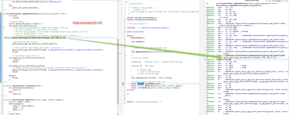

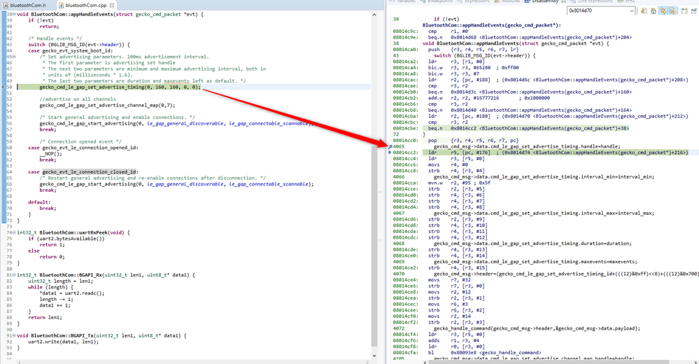

2020-06-02 2:45 AM
Sorry you are right, only the case gecko_evt_le_connection_closed_id is triggered with breakpoint in "C++" code.
But if put a breakpoint in Disassembly side it is executed :
2020-06-02 3:38 AM
If i add : -fno-inline in compilation options for bluetoothCom.cpp i see the function in map file and i can have a break point in c++ side when debugging. But it's not working yet ...
