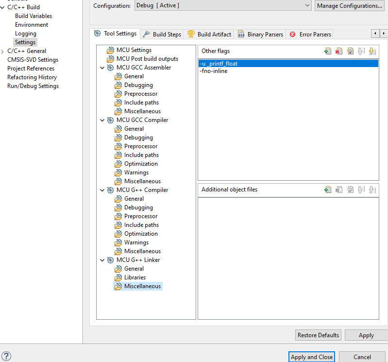

Hi all,
On our card with a STM32L4 we use a siliconLabs BGM13P32 for the BLE.
The L4 communicate with the BLE SOC in NCP mode (see here for more details).
To do that i have integrated the SiliconLabs libs (BGLIB) to our project on stm32cubeIDE.
The project build fine, with no errors/warnings (default options) and i can communicate with the BLE SoC ...only if i use -O0 option in optimization options.
If i use for example -Og, the functions used in BGLIB (siliconLabs) is removed from the binary (checked on .map file). The project build without errors but the com with the BLE SoC fails !
For information our project is in C++. Join with this post the class of our Bluetooth Com. (bluetoothCom.h/cpp).
The whole project is build with -Og optimisation option, just bluetoothCom.cpp use -O0 option to have a correct communication.
Do you have an idea how to resolve this ?

I have found the issue ...
On stm32 side i use DMA to transfert the data from uart to a circular buffer. The problem is that the SiliconLabs rxcallBack is implemented to read directly on uart register ...
I just modified my code like this :
int32_t BluetoothCom::BGAPI_Rx(uint32_t len1, uint8_t* data1) {
	uint32_t length = len1;
	while (length) {
		if(uart2.bytesAvailable())//needed to be sure DMA have transfert data from uart...
			*data1 = uart2.readc();
			length --;
			data1 ++;
	return len1;
added -fno-inline option to file compilation option and now all work fine !
Thanks all for your answer, i have learn a lot with compilation options !

I suppose you talk about this option :
MLE S.1
But this didn't working ...
Brian TIDAL
I guess the functions are not removed from the binary but just inlined. Can you add the following option : -fno-inline and verify that the functions are present in the map file?

I added -fno-inline here but the function is yet removed from the map file
