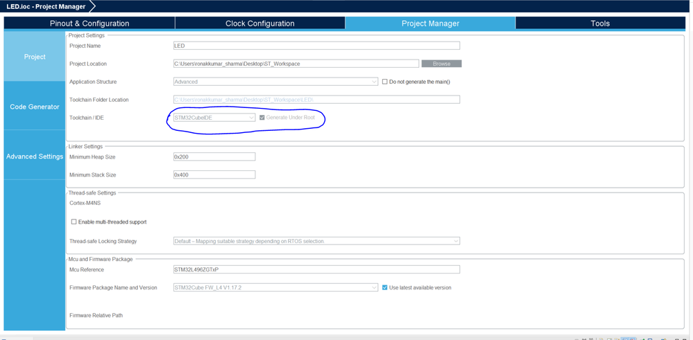

Hi , After pin selection and configuration when I try to generate code for keil it does not allow me to change the IDE in project setting, how can I do that?0693W00000Uo0jLQAR.png

Use the standalone CubeMX. CubeIDE won't generate for Keil.

Yes , Thank you Pavel.
