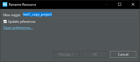

After Pasting one Project, and allowing Uptading Reference Button, I tried to open the *ioc file which issued "error". Then, I had to rename to the newest Project name, then I was abble to open the *.ioc file. So, I might ask: Is it the correct "project copy" task? Doesn't the CUBE aren't able to fix all the newest references, based on the newest copied file name? Regards.

Hello @JSILV.2​
I tried to copy a project and simply rename it as @Pavel A.​ mentioned. And this is what I found:
  • After copying the project, you can rename the *.ioc file and open it successfully with CubeMx
  • You can generate code and open the CubeIDE project
  • The only think I encounter is that the CubeIDE project keep the original name.
  • I was able to rename the CubeIDE project from CubeIDE 0693W00000UoB9dQAF.png
If this didn't solve the issue you have; could you, please describe in detail the steps you did so I am able the use case.

Dear Cherni.
The so called issue works as you just described. My conclusion is exact as you instructed me. Therefore, I made the best wayout.
