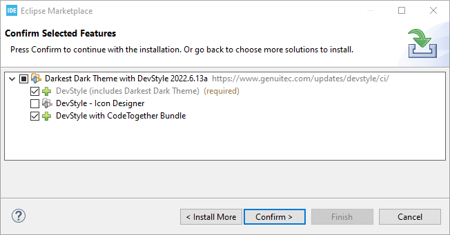

  • Click Install beside Darkest Dark Theme with DevStyle 2022.6.13a
Then I leave the default components selected and I click on the Confirm button:

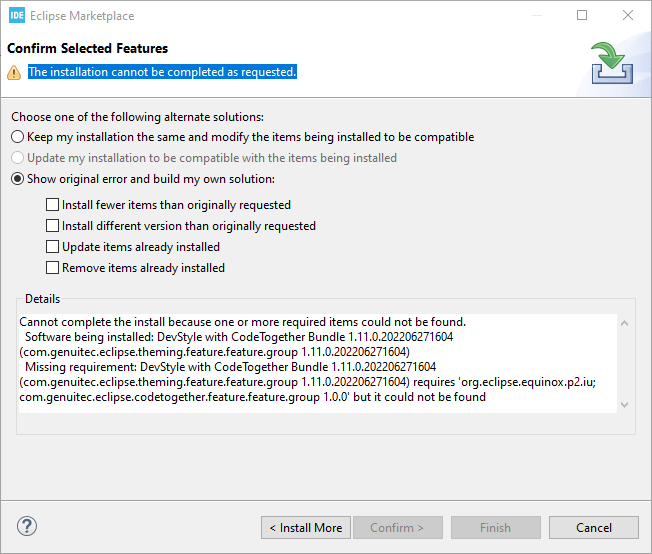

after processing the click for about 20 seconds, I get the following error displayed:
The installation cannot be completed as requested.
If I click Show original error and build my own solution radio button I get:
Here is the specific error message copy/pasted:
Cannot complete the install because one or more required items could not be found.
  Software being installed: DevStyle with CodeTogether Bundle 1.11.0.202206271604 (com.genuitec.eclipse.theming.feature.feature.group 1.11.0.202206271604)
  Missing requirement: DevStyle with CodeTogether Bundle 1.11.0.202206271604 (com.genuitec.eclipse.theming.feature.feature.group 1.11.0.202206271604) requires 'org.eclipse.equinox.p2.iu; com.genuitec.eclipse.codetogether.feature.feature.group 1.0.0' but it could not be found

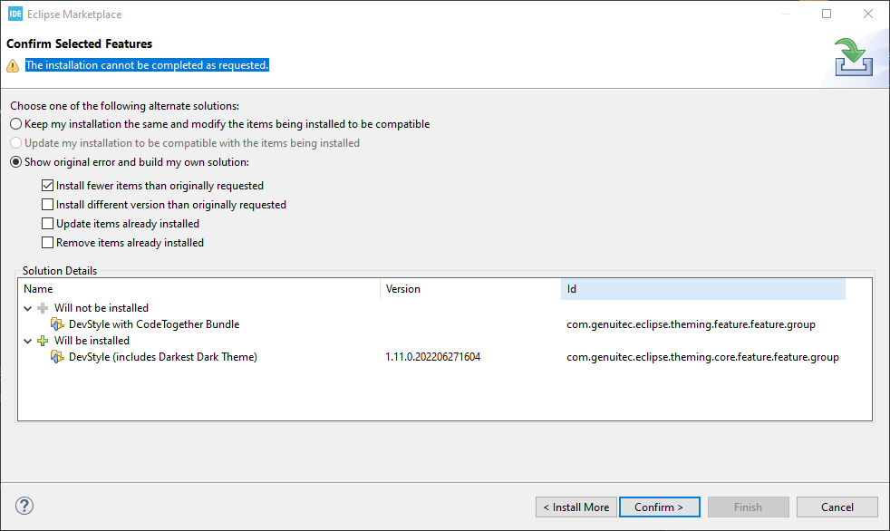

If I then select "show original error and build my own solution" and select Install fewer items than originally requested then it appears to break the IDE because I can no longer build my project after the IDE restarts following the partial install

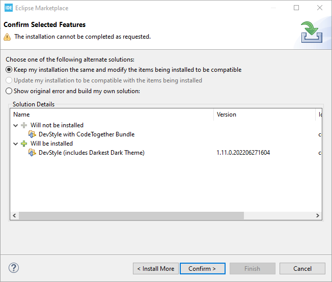

If I select Keep me installation same and modify the items being installed to be compatible option then it does the same thing (i.e. DevStyle with CodeTogether Bundle will not be installed.
If I use the IDE without the darkest dark extension installed (or partially installed) then it works fine.

AFAIK the issue is about the DevStyle with CodeTogether Bundle feature. If you simply get the required feature selected then it should work.
