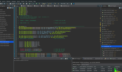

...this is how my IDE is looking:

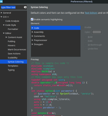

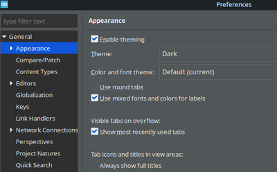

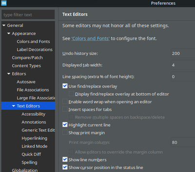

So more save: use the settings, that are already here: menu -> window -> preferences
- first:
- then: many ...editor, debug etc.
- and the syntax colors you like:

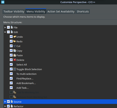

- and what it shows in menu and tollbars :
/for every perspective ! / edit / debug / Mx
menu-> window -> perspective -> customize...

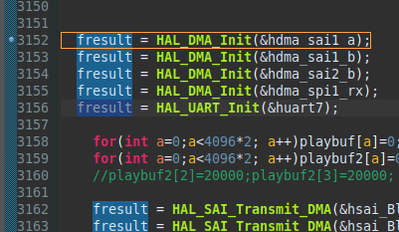

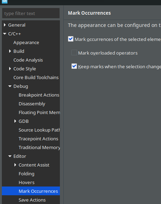

btw   - what i like :  mark occ. of sel. text

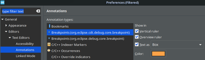

- and breakpoints better visible:
-> here : marked text "fresult" and a breakpoint
