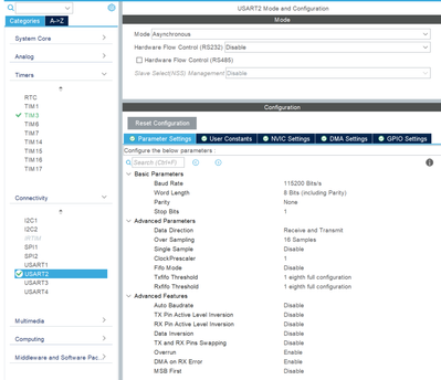

I am a newbie to CubeIDE and STM32 Mcus, and have spent hours trying to make interrupt callback work on a Nucleo-STM32G070 board.

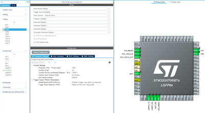

First, I tried HAL_UART_TxCpltCallback for USART2, this function is not called, then I downloaded an example project TIM_TimeBase which works, but when I added the timer 3 into my test project with the same configuration as in the example project, it does not work.
I must have missed something in configuration in my project.

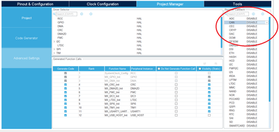

the Priority is not configurable
again, the Priority is not configurable

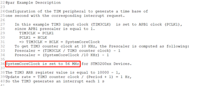

As for the Timer 3, I am a bit confused by the calculation of the prescaler in the example project, could someone clarify it to me:
Actually, in system_stm32g0xx.c, it is defined as follow:
uint32_t SystemCoreClock = 16000000U;

In order for HAL_UART_TxCpltCallback to be called, you need to start UART reception in IT or DMA mode. Are you doing so? Show the code. Are you sure data is coming in on those lines? If you use blocking function call (HAL_UART_Receive), do you get data?

Thanks a lot, I indeed did not use HAL_UART_Transmit_IT!
However, when I use HAL_UART_Transmit_IT, the callback is allright now, but the following code prints only the character 'H' every second (it prints both "Hello World" and "hello universe" when use HAL_UART_Transmit):

The TIM3 interrup did not work because CubeIDE did not generate the following code in main.c:
HAL_TIM_Base_Start_IT(&htim3)
Now, the HAL_TIM_PeriodElapsedCallback is called, and the HAL_UART_TxCpltCallback is called twice for the 2 printf calls, but the printf in while loop prints only 'H' and the printf in TIM3 calback seems to print the '\n'.
