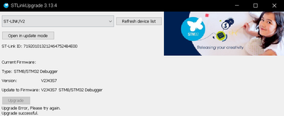

I can't update my ST-Link V2
When i try to update first it says update error after that update succesfully.

What OS? You're already at the current version.
In Win7 there can be quite a significantly lag between "Open in update mode" and the drivers being installed properly for the different device it presents.
Potentially other issue is apps, like Keil etc, have a currently open context with the ST-LINK.
Serial# doesn't look obviously fake

I fix it thanks for reply.
I fix with hex folder.
