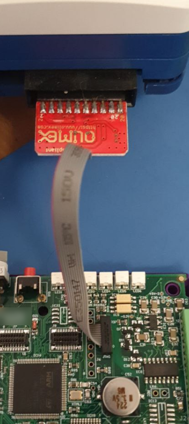

I have tried all kinds of things over past 2 years, on several development setups, some win7-64 and some win10, some stlink v2 isol and some stlink v3 and some stlink v3 isol. All of them fail sometimes. I have tried different debugger speeds, all the way down th silly stuff like 1MHz (stlink v3 should do 24MHz, v3 isol about 8MHz). And different ITM console speeds too. Nothing really makes much difference; the USB end needs unplugging to recover the debugger.
Also a frequent issue on some systems is the debugger losing contact with the target, so you lose any breakpoints you are waiting on. Have to rebuild/reload with F11.
Re target cables, I have done all kinds. This is the shortest I can do. I am using the Olimex 20way to 10 way adapter and a very short 10 way cable (out of the STLINK cable set) and you can see how close the CPU is.
If I plug that 10 way cable directly into the 10 way socket in the debugger, it works but much less reliably than using the 20 way socket on the debugger.

These error messages are propagated from ST-LINK firmware. Will see if we can get some experts on the ST-LINK into the loop. Why? Not sure. Normally, long wires, too fast SWD speeds. Could also be an ST-LINK firmware bug.
