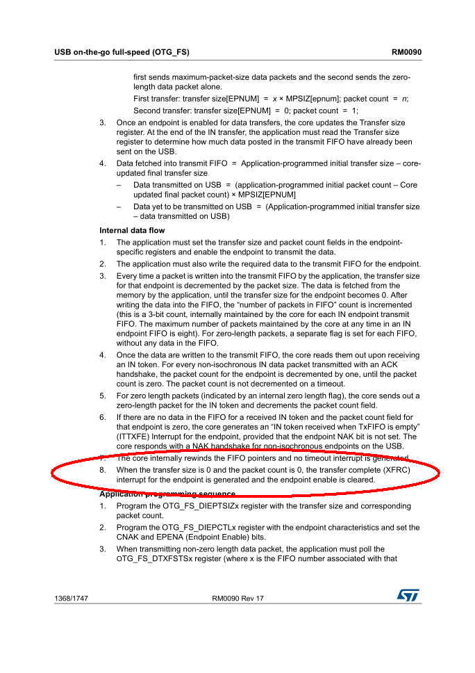

> My Q is whether there is any way to tell when that data has been consumed.
Yes. And it's described exactly where you would expect it: in the manual.
0693W00000SuSHdQAN.pngIt's used in multipacket transfers.

waclawek.jan
> So there should be a "transfer complete" interrupt somewhere.
Yes. And the manual clearly says, where and how it is called.
> I don't think it has been implemented.
In hardware? Of course it is. In Cube? I don't care but yes, it is, in some way. Look it up, Cube is open source.
Have you read the Cube USB Device driver's manual?
> The ideal way to do this is to have an "all sent" flag, or some such.
Then implement it. I've just told you, how. It's your program.
waclawek.jan
OK looked it up for you in a 'F4 Cube v1.21 CDC example.
The In XFRC interrupt calls HAL_PCD_DataInStageCallback() (or the same through the "registered" mechanism) which as with all callbacks is implemented as weak and is supposed to be implemented by user.
The CDC example implements it as a straighforward call to USBD_LL_DataInStage(), which for non-EP0 implements the multi-packet transfers and finally calls pdev->pClass->DataIn(), that in the CDC example points to USBD_CDC_DataIn() and that appears to signal through hcdc->TxState = 0;
