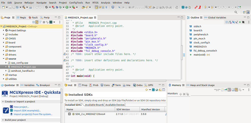

I'm not sure if it's a bug or not but the MCUXpressoIDE works as expected. In this case If you create a C++ project the IDE generates a .cpp main file (MKE06Z4_Project.cpp). This is a natural workflow to me without doing workarounds.

In this case it may be more appropriate to speak of 'very' nice-to-have feature.
The MCUXpresso libraries are also written entirely in plain C and if you create an MCUXpresso project in C++ you can call them from main.cpp without limitations. On the other hand, if you create a C project you won't be able to call libraries/functions written in C++.
Basically, creating a project in C++ should allow calls to C/C++ functions/libraries from main.cpp while a project created in plain C (main.c) will only allow calls to library functions written in plain C. I think no one will feel upset about this.
Despite creating a C++ project the STM32CubeIDE only generates a plain main.c instead of main.cpp. This makes it impossible to call C++ functions/libraries from main.c. I would have no problem renaming the file once but if I do multiple pinmux/peripherals updates they all generate a main.c and this workflow is no longer efficient at all.
