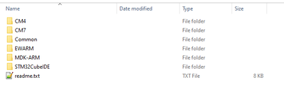

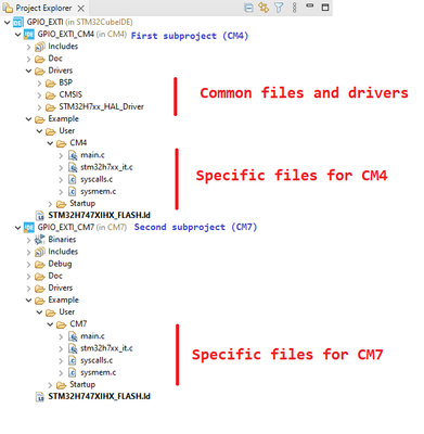

You can refer to any H7 Dual core examples.
Lest' say a very simple project toggling a LED using EXTI from here.
For example the HAL and the BSP are common to the two cores as well as system_stm32h7xx.c file. But some files are specific to one core.
This is how structured in CubeIDE. In fact there are two subprojects (GPIO_EXTI_CM4 and GPIO_EXTI_CM7) under a parent project (GPIO_EXTI).
Each subproject has its own configs, paths, flags, etc ..
If you have your own library that is common to the two core, physically (on your drive) it will be available in one place, but you need to include it in CM4 and CM7 if it's used by both.
You need to refer to one of the projects in STM32CubeH7 package or you can start a project using CubeMx and it will make it for you.
