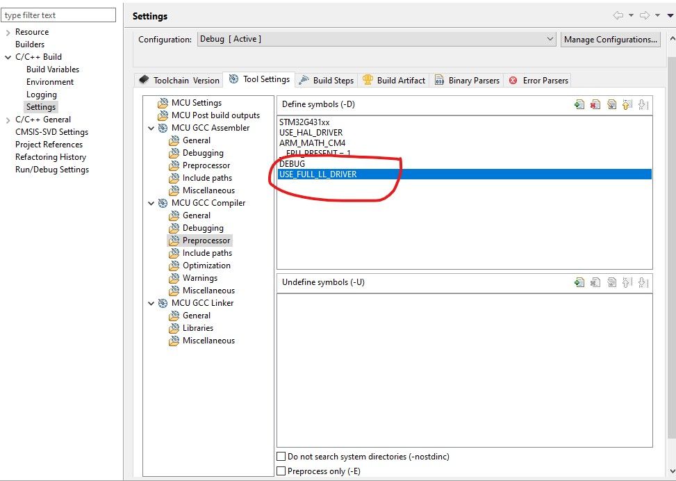

I added the "USE_FULL_LL_DRIVER" symbol in my project properties:

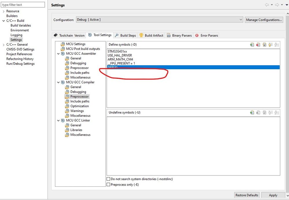

Subsequently I used "Device Configuration Tool" to re-generate the code (even without having made any configuration changes). At the end of the generation, the previously added symbol disappeared:
Obviously if I then try to compile I get an error: I have to add my symbol in the properties again. Really frustrating.

Today I was facing a similar issue, went to the Project Manager :: Settings sections of the MX tab in the CubeIDE 1.1.0 and configured some of the HAL components to be implemented with LL and the symbol reappeared.
It looks like the generator modifies this symbols depending on whether there are actually components implemented with either HAL or LL or both in the generator, which to me it makes quite sense. We could argue whether the generator should preserve the user defined symbols or not, but that's not the point.
Regards,
From what I understand, the code generator changes everything that could have generated it at another time without considering anything else. So the generator won't change the symbol you created if it doesn't have the same name as the ones it uses. The fact is that that symbol must necessarily be with that name, otherwise the program cannot be compiled.
However I made the report directly through direct support and after numerous tests and exchange of messages, they informed me that this problem will be fixed in a later version. We will see how long we have to wait ..... :beaming_face_with_smiling_eyes:
