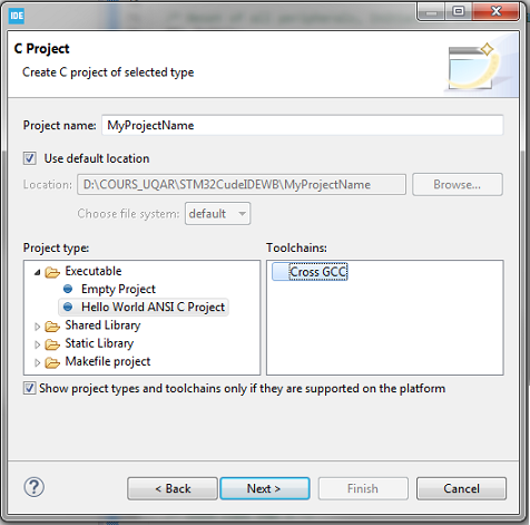

I'm preparing a basic embedded programming course. I will use some Nucleo boards with CubeIDE. For the bases of C and C++ programming, I also want to use CubeIDE but I didn't found the documentation for configuring STM32CubeIDE to compile a simple ANSI C project with the Cross GCC toolchain.
Can someone help me what's missing to the Eclipse core of STM32CubeIDE to be able build ANSI C project?

Thanks for your answer but for the bases of C and C++ programming (while, for, if...else, etc.), I don't want to use any board. I wish to use CudeIDE as a simple console program like Code::Blocks before introducing the idea of peripherals (GPIOs, USART, ADC, etc.). I wish to be able to use the same IDE. It's quite easy to use CubeIDE to configure any peripherals but it doesn't structure a program. This programming course is the first step in programming and I don't want multiple IDEs.
I'm asking this question because if your go to File - New in CubeIDE you can select C/C++ Project and do a basic HelloWorld ANSI C project. But CubeIDE needs some configurations to set some paths (includes, gcc complier, etc.) to works. I already done something like that with AtmelStudio but I want to change to STM32CubeIDE this year. I already solve the path for the includes but not for the compiler.

Do you want the compiled program to run on the PC? I don't know if it works or whether STM32CubeMX can do it at all but you might try:
Install a gcc compiler for your platform first (Cygwin or mingw on Windows).
When selecting the project type, uncheck Show project types and toolchains... at the bottom.
‎2020-05-15 5:12 AM
Your question is not very clear what you want achive. I have attached a screen shot with a window for project creation. CubeIDE should be able to build anything because it is Eclipse . You need to have the right software installed and it looks like you can build even PC applications unless it is somehow blocked.
‎2020-05-15 8:30 AM
Hi berendi
Yes, I want to run simples ANSI C or C++ programs on the PC from STM32CubeIDE. I'm almost there.
I had already MinGW GCC installed on my PC that I'm using with CodeBlocks.
In changing the toolchain for MinGW GCC (Properties > C/C++ Build > Tool Chain Editor > Current toolchain > MinGW GCC) and the path (Properties > C/C++ Build > Environnement > Environnementvariables to set > MINGW_HOME > C:\Program Files (x86)\CodeBlocks\MinGW) I was able to make the simple "HelloWorld" program works as expected but once. Now when I rebuild the project, I get this stange error message :

‎2020-05-15 9:25 AM
The program might not have terminated properly. Try to find and kill it in the task manager, or restart the PC.
Also, eclipse doesn't like paths with spaces or other funny characters in it, try reinstalling mingw in c:\mingw​, it might work better.
