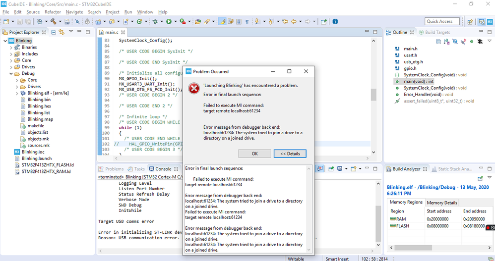

Error while programming the Nucleo board from stm32cubeIDE
mani s
0693W000000XN9gQAG.pngIm getting this error always when trying to program Nucleo board from stmcubeIDE or Truestdio ide.
I have tried uninstall and Install IDE. And I have changed may cables also to program.

It got resolved by upgrading the st-link.
Go to Help-> ST link upgrade , thats all - error is not coming now
