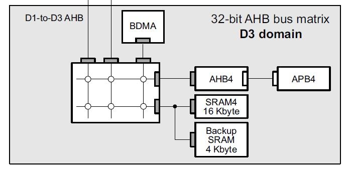

hello
ı use stm32h723zg and ı use bdma for adc3 , I was wondering if bdma can be used with adc3. I looked in the reference guide but couldn't find it. I will be glad if you help.0693W00000HnnvbQAB.png

There was no problem in DMA1-2
0693W00000HnhZeQAJ.jpgYes, because they have a richer bus matrix for connectivity.

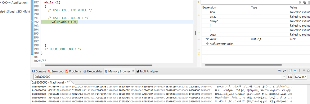

BDMA_InitStruct.MemoryOrM2MDstAddress=0x38000000; // To test
You could assign a pointer
Alternatively describe the memory region in the Linker Script and use __attribute__ section directives to push into that region.

I did what you said. But the result did not change, the image is below0693W00000HntLKQAZ.png
Assuming that CubeIDE is incapable of dumping the BDMA registers perhaps you can send that data via a console/terminal connection.
The ADC likely wants a continuous/circular DMA, and it's not clear why reading the same register in a tight while loop would be helpful here.​
