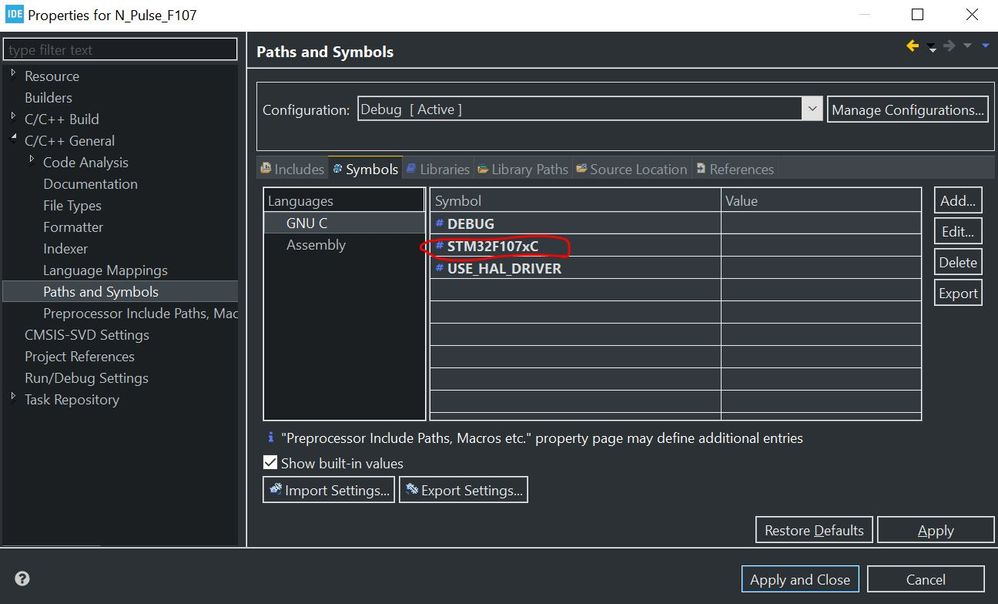

prain
Senior III
In cubeIDE there is a symbol defined in compiler settings:
5 REPLIES 5
There is a per-chip define. Look at the top of the "stm32f4xx.h" and similar files. For the F4, it's one of these:

There is a per-family define "STM32F4" but it's not really used and STM32CubeMX doesn't add it. You'd have to define it yourself.
prain
Senior III
very true, all compilers have compile options and label names. only drawback is syntax is compiler dependent and not part of source code. a global include file is another way.
