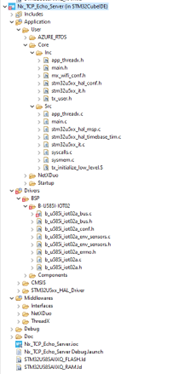

The project architecture is as follows:

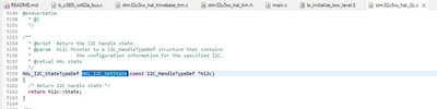

What I've noticed is that when I access the function where the error occurs (e.g. HAL_I2C_GetState), I'm able to access the .c file, as shown in the following image:
Other modifications include:
I don't really understand why I'm getting these errors, because when I ctrl + click on the function with the error, it opens the .c file with the appropriate function.

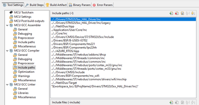

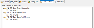

In project settings -> C/C++ General -> Paths and Symbols -> Source Location, ensure that the HAL library source code file path is in there.
When you compile the project, ensure stm32_*_i2c.c is being compiled.
In your *_hal_conf.h file, ensure the I2C module is being enabled.

I'm afraid your Project screenshot is too low-resolution to read.
