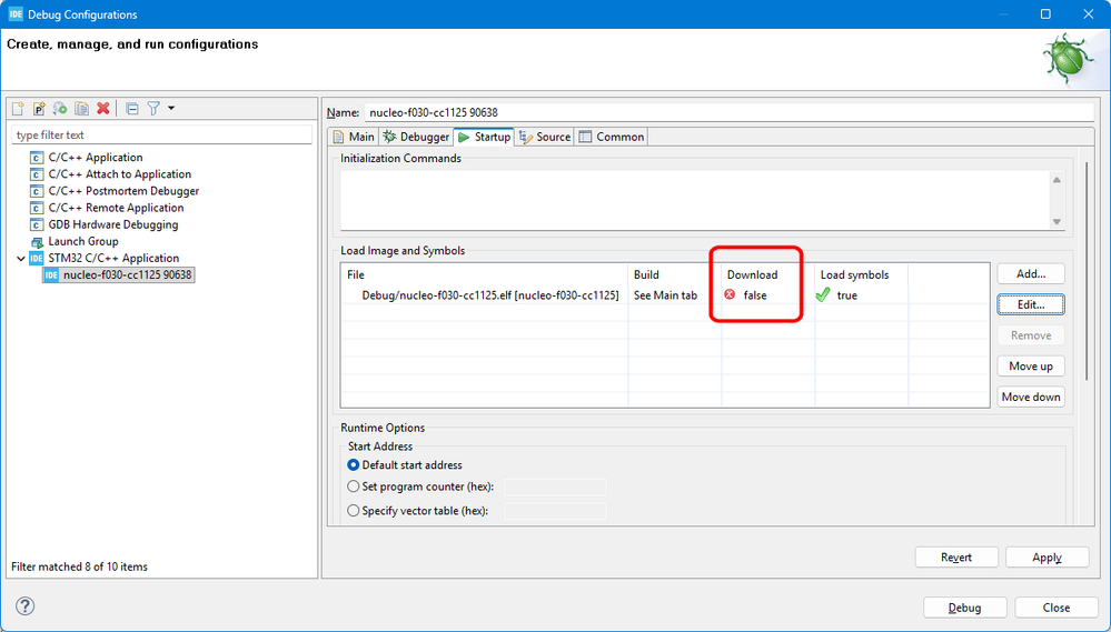

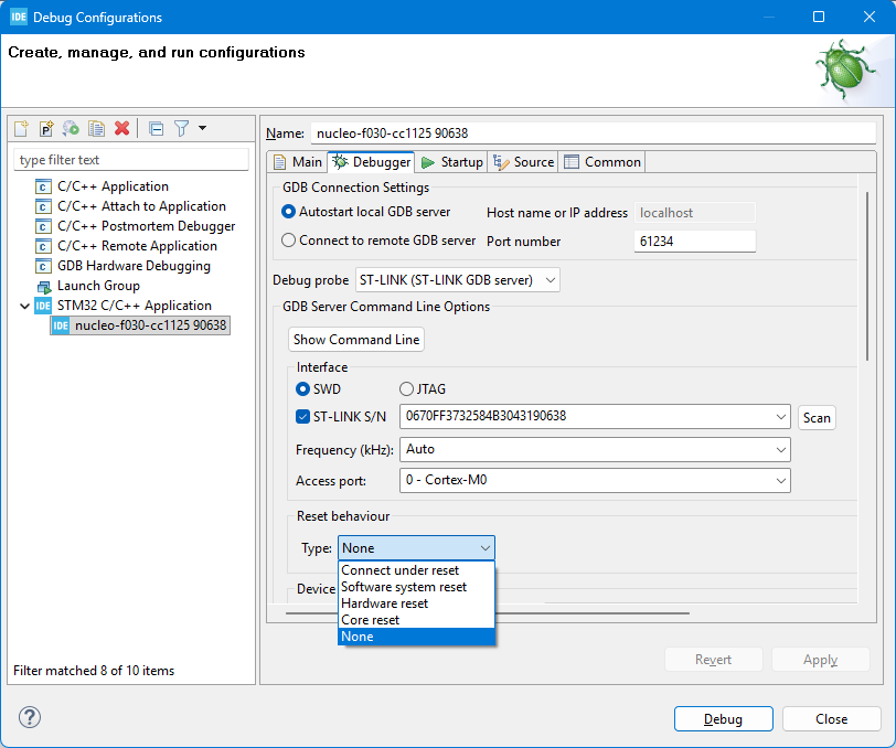

How can I attach to running microcontroller in the STM32CubeIDE?
The IAR has the Attach to running target function. The STM32CubeIDE have not this function.
Andrew Neil
Create a Debug Configuration with 'Reset  behaviour' set to 'None' and 'Download' disabled:
#AttachToRunningTarget
1 REPLY 1
