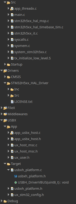

So i tried the "new" H563 , on NUCLEO-H563ZI , using SD-card and USB-stick as storage and driving USB-audio-host. ok, it has only one usb-port, so i tried just make an audio-host at first.
but surprise, i cannot use FATFS, because no more there in Cube, only Azure rtos and Filex from M**bleep** to choose...
ok, so i tried this. Nothing working - what a surprise.
And the only existing example is made only for IAR , not easy to get it to stm-IDE in any useful way.
So i tried now a new simple project: just use USB-MSC , to connect a USB-stick -- to see, whats missing , to get it activated in my usb-audio-host.
But surprise, not working...out of the box. :)
see: this its usb handling:
yes, really doing nothing. perfect tool.
in old times, with fatfs and "simple" usb lib, on H743 i did usb-msc-host, working really:
in my simple understanding of such complex thing, as connecting an usb-stick , this old MX generated code did something useful, the new "improvement" with Azure/rtos i just dont understand - for my small brain it just looks like people with no brain at all working here to do the best they can.

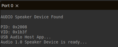

for audio host :   unbelievable , but the basic problem was: the USB port was not powered at all !!!
in xxx_hal_msp.c  i had to add:
void HAL_HCD_MspInit(HCD_HandleTypeDef* hhcd)
  if(hhcd->Instance==USB_DRD_FS)
  /* USER CODE BEGIN USB_DRD_FS_MspInit 0 */
  /* USER CODE END USB_DRD_FS_MspInit 0 */
    __HAL_RCC_GPIOA_CLK_ENABLE();
    /**USB GPIO Configuration
    PA11     ------> USB_DM
    PA12     ------> USB_DP
    GPIO_InitStruct.Pin = GPIO_PIN_11|GPIO_PIN_12;
    GPIO_InitStruct.Speed = GPIO_SPEED_FREQ_HIGH;
    GPIO_InitStruct.Alternate = GPIO_AF10_USB;
    HAL_GPIO_Init(GPIOA, &GPIO_InitStruct);
    /* Peripheral clock enable */
    __HAL_RCC_USB_CLK_ENABLE();
    /* USB_DRD_FS interrupt Init */
    HAL_NVIC_SetPriority(USB_DRD_FS_IRQn, 3, 0);
    HAL_NVIC_EnableIRQ(USB_DRD_FS_IRQn);
  /* USER CODE BEGIN USB_DRD_FS_MspInit 1 */
    HAL_PWREx_EnableVddUSB();       // this was missing !!!! so no power at all...
  /* USER CODE END USB_DRD_FS_MspInit 1 */
+ then, with power enabled, surprise, surprise -- it begins to work !

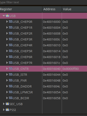

so...is the state machine (usb_connect /..disconect etc) populated there ? or empty frame like i see on H563 ?
and where is activation/setting of usb peripheral (hardware) ?
in all these files with very informative and creative names i cannot find, where the hardware is set to useful state:
the usb registers just stay at this state without any change :

@AScha.3 can you share what you needed to change to get the USB host working?

@AScha.3 brilliant, thank you!  I was missing the call to HAL_PWREx_EnableVddUSB() so the USB registers were just sat there not signalling any device attached.
