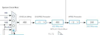

Anyway:

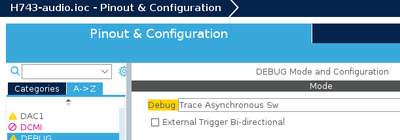

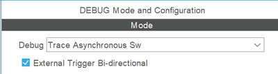

-debug setup in CubeMX looks little bit different, I have chosen this:

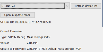

- firmware of ST Link V3 is (I seen some posts on other problems suggesitng to downgrade, I don't know if it is a case here, moreover, I don't know how to dongrade to selected version):

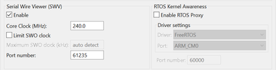

-debug config seems to be recognizing proper clock:

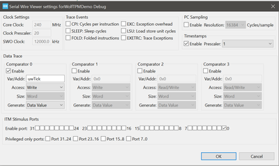

-I try to set up SWV to see just uwTick, nothing happens in SWV data window when running the SW:
- surprisingly sometimes, when playing with sampling setting, I see sometimes few values displayed in trace window but it hangs up anyway and is randomly working = completely useless

You set core clk to 480MHz - but in debug SWV you write 240MHz ;
if not giving korrekt frequency , swv dont work.  So set 480, if core is at 480.
I choose this (its working):

The number you give as the "Core clock" in the dialog is the value of global variable SystemCoreClock after you call SystemClock_Config() divided by a million. For example, 240000000 -> 240.0
(by the way - this is why the SWV/ITM trace won't work until SystemClock_Config returns ;)
