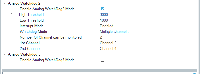

I was faced with an issue that watchdog works only with one channel.
My analog watchdog settings:

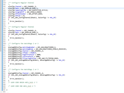

After generating code, ADC file shows:

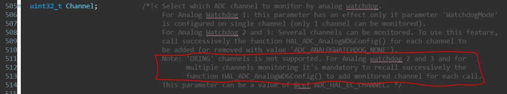

When I was investigating, found this comment in stm32u5xx_hal_adc.h file, ADC_AnalogWDGConfTypeDef structure definition:
After applying what is mentioned in the comment, watchdog works on both channels.
Please fix this configuration bug. Thanks.

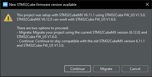

Would you mind sharing your OS and indicating if you have installed CubeMX 6.12.0 from the ST official site or used the update option?
THX
Ghofrane
‎2024-07-09 11:06 PM
My OS is Windows 10 and I used update option.
‎2024-07-10 12:20 AM
Hello @S-E
What was the previous version that you updated?
THX
Ghofrane
‎2024-07-10 12:26 AM
It is shown here:
‎2024-07-10 12:32 AM
