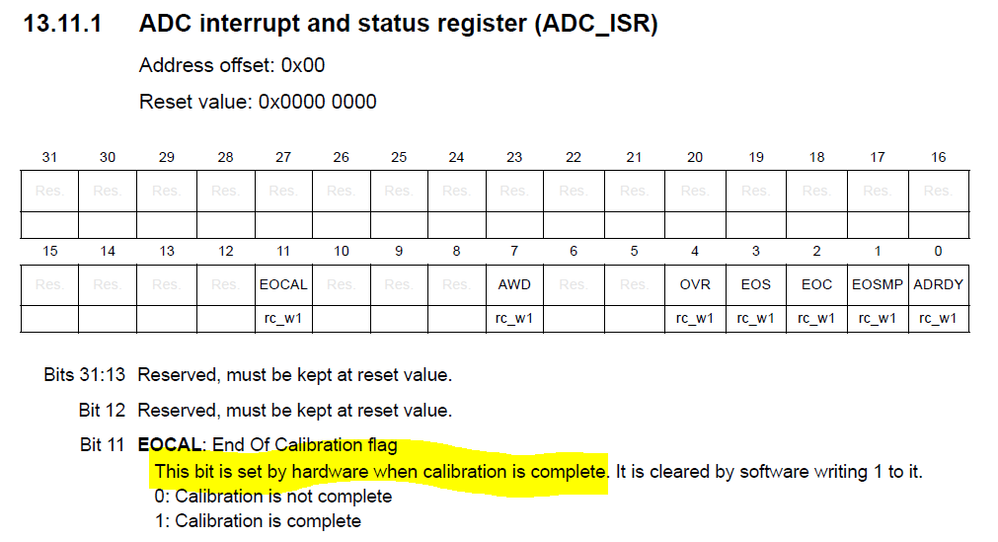

 Trying to calibrate the ADC at startup with the following code into the initialization procedure:
   ADC1->CR |= 0X80000000;      // calibration started
   while (!(ADC1->ISR & 0X800));   // waiting for the calibration to finish
 When compiled with Atollic, version 9.2.0, this code works perfectly. But when compiled with Stm32CubeIde, it gets trapped into the calibration command which never finish!

EOCAL is set at the end of the calibration. You're waiting until it's set. This is a race condition. So either the loop will immediately pass (if calibration isn't done yet), or it will never exit.
This is a software bug, not a CubeIDE issue.

Use code tags when posting code. And use the readable CMSIS defined bit field names.
if (ADC1->CR & 1) ADC1->CR |= 2;  // ADC setup
   ADC1->CR |= 0X80000000;       // ADC calibration started
   while (!(ADC1->ISR & 0X800)) { // waiting for the calibration to finish
      watchdog();       // macro to refresh the watchdog
      if (!--n) return FALSE;    // failure exit
   ADC1->ISR |= 0X800;       // clearing EOCAL
Do not use read-modify-write on ISR register and be careful with CR as it also has "rs" bits like ISR. Probably the most important - you are not waiting for ADDIS command to complete. And ultimately I would want the watchdog to act if the code gets stuck in that loop...

> 1 - STM32L030F4P6 chip on my desk, and on my board!
Can you link the product page to prove that it does exist? Google shows no hits. Maybe you have a counterfeit part. Hard to prove a negative.
> 2 - Read-modify-write instructions? there is no such a warning in the datasheet. I also have separated them in 2 parts with no avail.
This clears ALL flags, not just EOCAL. This is covered in the reference manual (for STM32L0X0). To clear only EOCAL:
ADC1->ISR = ADC_ISR_EOCAL;
There are other requirements for starting calibration and you're not checking for them all. From the reference manual (for STM32L0X0):
The software is allowed to set ADCAL only when the ADC is disabled (ADCAL=0, ADSTART=0, ADSTP=0, ADDIS=0 and ADEN=0).
