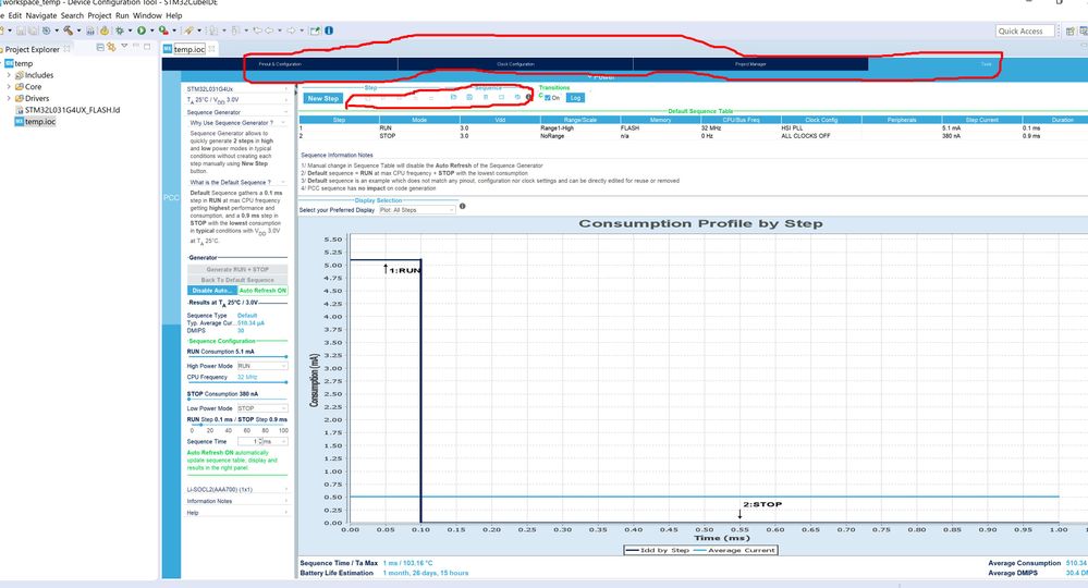

0693W000000VJX6QAO.jpgHi Aymen,
Thanks for this tipp!! Found it under
Window > PREFERENCES > STM32Cube > Device Configuration Tool > Font size.
This indeed helps for most of the text, but especially the text in the registertabs and the icons are not are not (yet) influenced by that (see attached screenshot). But it's definitely possible to work like this, thanks!
