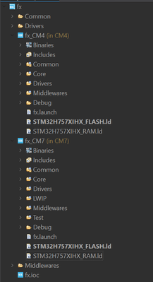

I have a STM32 project created for STM32H757 which has dual core CPU. The directory structure is look like this:
I wanted to build this project using command line in my ubutnu machine. I have tried with this command:

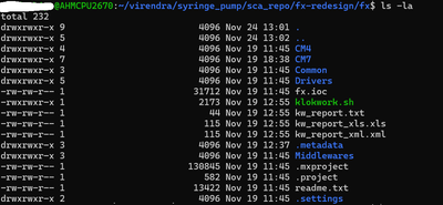

I am running this command from the root directory. My actual path for the project is:
/home/virendra/sca_repo/fx-redesign/fx
Here are the contents of this path:
After couple of retries, I have changed a command a bit to this:
$ /home/st/stm32cubeide_1.12.1/stm32cubeide --launcher.suppressErrors -nosplash -application org.eclipse.cdt.managedbuilder.core.headlessbuild -data "/home/virendra/sca_repo/fx-redesign/" -build fx
And, response was this:
Project: fx doesn't appear to be a CDT project. Skipping...
WARNING: No Config matched "fx". Skipping...
Hello @virendra_dalal
fx doesn't appear to be a CDT project. means that CubeIDE does not recognize it as an Eclipse/CDT project,
Could you please check if any of your project files are missing (i can't see .cproject in your path) or try to re-import your project in stm32CubeIDE;
