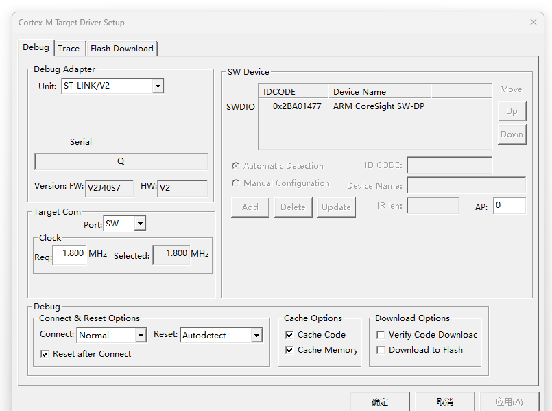

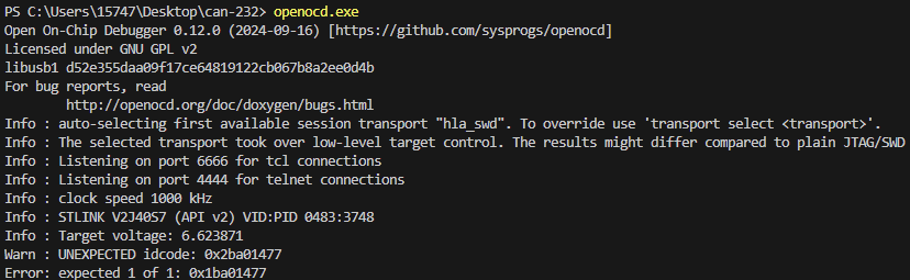

When vscode+stm32cubeclt+openocd was developing stm32f103c8t6, this problem appeared on a board. openocd detects that the board idcode should be 0x1ba01477, but the actual detected idcode is 0x2ba01477. Then I can't burn it or debug it. However, keil can also recognize 0x2ba01477 and can be burned and debugged normally. Related pictures are as follows
What board?
https://community.st.com/t5/community-guidelines/how-to-write-your-question-to-maximize-your-chances-to-find-a/ta-p/575228
Are you sure that it's really an stm32f103c8t6, and that it is genuine?
See this thread:
https://community.st.com/t5/stm32-mcus-products/blue-pill-stm32f1-board-gets-programmed-through-arduino-ide-but/td-p/667923
In particular:
https://community.st.com/t5/stm32-mcus-products/blue-pill-stm32f1-board-gets-programmed-through-arduino-ide-but/m-p/667958/highlight/true#M242518
