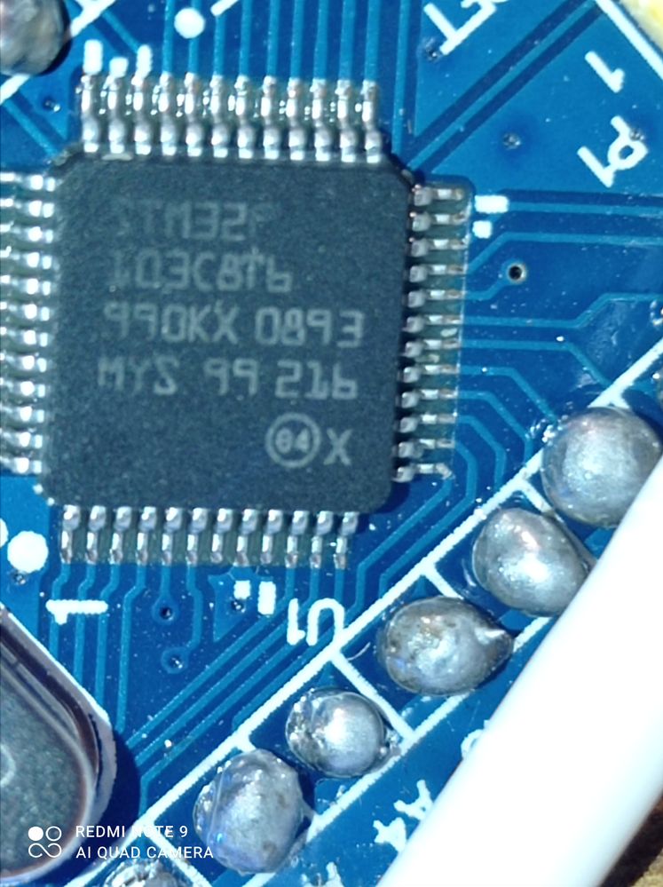

AScha.3
Apr 29, 2024 12:50 PM UTC
Maybe you can work with Keil , if you select the chip, thats real on Blue pill board .
If GD32F103C8 , you should set this as target...just look, what you have.
IMumt.1
IMumt.1Author
Apr 29, 2024 1:09 PM UTC
On board it's STM32F103
AScha.3
Apr 29, 2024 1:19 PM UTC
Can you show a good picture of the cpu on this board ?
btw
ID: 0x2BA01477  is CS32F103C8T6  by CKS .
Andrew Neil
Apr 29, 2024 1:05 PM UTC
Peter BENSCH
Apr 29, 2024 1:15 PM UTC
@IMumt.1 ...whereby the marking with this text says absolutely nothing about whether it is an original or a fake. For STM32F103 in particular, third-party labelling is ground off/etched off and a fake marking is applied. You can only recognise this with tools that measure into the STM32F103, such as those mentioned by @Andrew Neil.
Peter BENSCH
Apr 29, 2024 2:11 PM UTC
At least the counterfeiter has omitted the ST logo.
